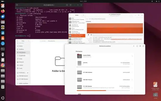

Here is a screen shot to provide the information referred to by David and user 68186,
Terminal output + Disks + Disc Usage Analyzer:
I was unable to use the fancy brackets for terminal output as I am using a different pc to do this post, no internet on the busted one at present! Hope this all works and you can see the screen shot.
I have noted that pvdisplay is in dispute with Disks and Disc Usage Analyzer about how full the disc is!

The key answer seems to have been removed!? That was that I could click on the underlined Red coloured file route/name in Discs and then I could see my files and have access to them! For me this has been educational. I am 'slow' to respond because it has taken me this long to actually understand enough of what you have been saying and be able to actually do it.

I'm not expert on LVM either, but here is what I got from using Arch with LVM in LUKS2:
You need to mount the disks to access them. Gparted is unable to do that afaik.
First, unmount the disks since they seem to be mounted somewhere under /media in your screenshot:
# umount /dev/vgubuntu/root
Then mount them somehwere you can find them:
# mkdir /mnt/old-root
# mount /dev/vgubuntu/root /mnt/old-root
Then check if you can access the files in there.
