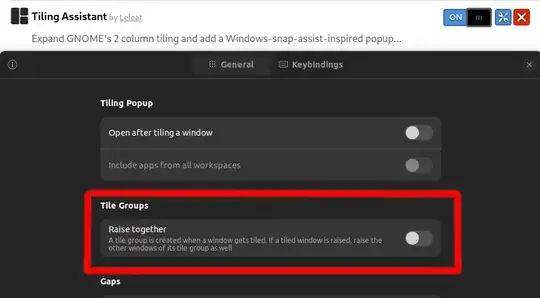

As drmuelr alluded to in the comments, this is a feature from Ubuntu 24 which has been backported through the Tiling Assistant by Leleat gnome extension that I had installed some time ago, and forgotten about before noticing this behavior.
I was able to disable the popup and behavior as desired through the gnome extensions browser interface: screenshot of relevant extension settings with option "Raise Together" highlighted
