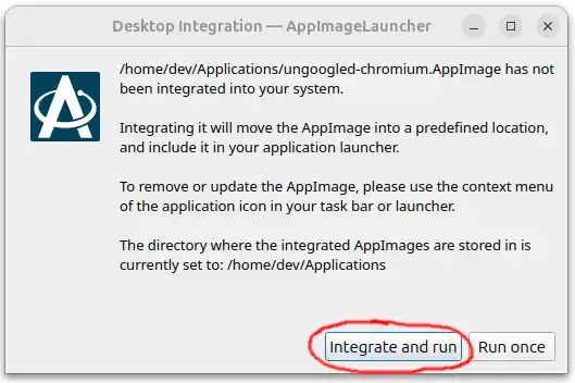

Start the ungoogled-chromium.AppImage file and click on Integrate and Run when the AppImageLauncher pops up. This will automatically create the required .desktop file in ~/.local/share/applications. The AppImageLauncher may rename your ungoogled-chromium.AppImage file to something like ungoogled-chromium_fb8ef8b1293fa7f66ca83453aa2da417.AppImage.
Desktop Integration - AppImageLauncher
