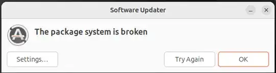

Update: Fun fact, obviously I wanted to install the display link drivers again to get my docking station to work. And this actually removed the evdi-dkms package again. But fortunately my system kept working fine.
Update2: After installing the display link drivers again it does kind of break my Software updater: enter image description here
