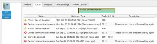

**The HP device manager says**
"Unable to open device hp:/usb/hp_LaserJet_1000?serial=0."
**When I ran {hp-setup}
HP Linux Imaging and Printing System (ver. 3.23.12)
Printer/Fax Setup Utility ver. 9.0
Copyright (c) 2001-18 HP Development Company, LP This software comes with ABSOLUTELY NO WARRANTY. This is free software, and you are welcome to distribute it under certain conditions. See COPYING file for more details.
QSocketNotifier: Can only be used with threads started with QThread Searching... (bus=usb, search=(None), desc=0)
error: No devices found on bus: usb
From the HP Device Manager Printing Status: enter image description here

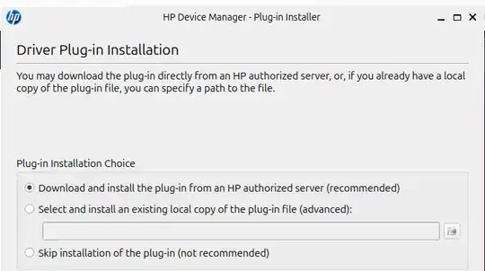

HP says I need a BINARY PLUGIN
When I ran {hp-plugin}
billschell@2022:~$ {hp-plugin}
Plugin Download and Install Utility ver. 2.1
HP Linux Imaging and Printing System (ver. 3.23.12) Plugin Download and Install Utility ver. 2.1
I clicked "NEXT"

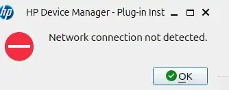

More from the Terminal
Checking for network connection...
error: Network connection not detected. error: Failed to install Plugin. error: The device you are trying to setup requires a binary plug-in. Some functionalities may not work as expected without plug-ins. Please run 'hp-plugin' as normal user to install plug-ins. Visit http://hplipopensource.com for more infomation.
Run {hp-plugin} again
