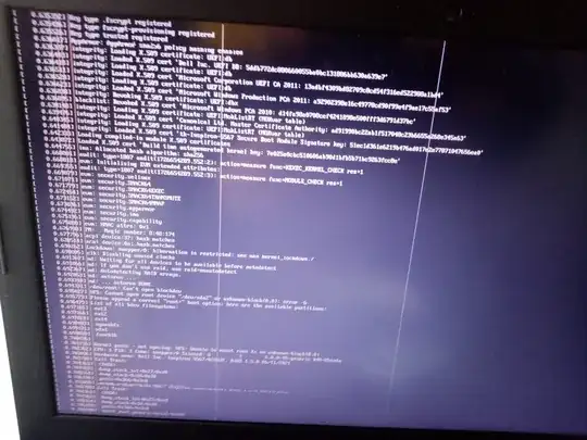

Screenshot
My PC fails to boot up and I observe the following output on my monitor.
It seems to fail at the lines:
/dev/root: Can't open blockdev
VFS: Cannot open root device "/dev/sda2" or unknown block (0,0): error -6
/dev/sda is the main SSD drive in which the Ubuntu 24.04.1 is stored.
Is the SSD corrupted so that the op sys can't be read into RAM ?
In the hope that it wasn't that I tried to restore (via Timeshift) the previous day's state of the 24.04.1 but it just won't boot up. It seized soon into the boot-up sequence and would go no further.

Changed SSD but after reinstalling 24.04 with kernel 6.8.0-45 and then rolling back to last state before the bootup crash, I got the same boot failure and for same cause.
** So it is not disk damage. **
Ideally I would like to get the new 24.04 kernel 6.8.0-45 and then reimport all my application prpgrams and config files, etc. But I am not sure if Timeshift allows this manoeuvre.
EDIT 3
This is all a consequence of Ubuntu 24.04 having a bug in it that prevented it working properly after it was installed as an update to 22.04.4 LTS. As soon as a kernel update is done the bug kicks in.
No cure like system restoring is possible. So it's a case of a fresh install of Ubuntu 24.04 to a cleaned SSD drive and then use a backup tool like BackInTime with your backup drive to restore data files.
