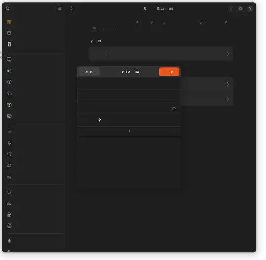

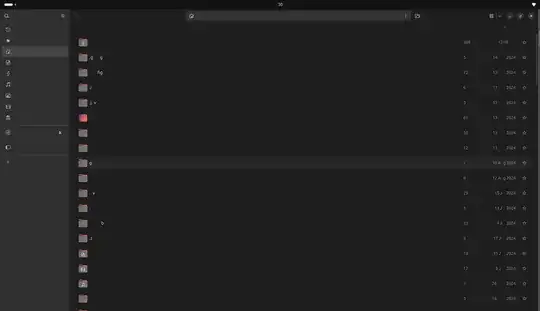

I've tried restarting the computer but it still remains corrupted. I have no idea how to navigate through settings beyond the icons - it garbles up my password too, it still works, but the text is corrupted on my screen for all system settings and when listing folders, desktop icons seem to be okay still: enter image description here enter image description here

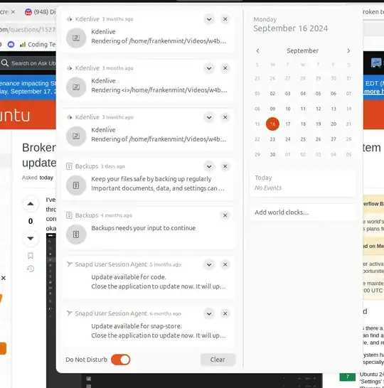

edit 1: Swapping between light mode and dark mode did fix my notifications window and the basic wifi-settings portion!, still broken settings and folder view though :(

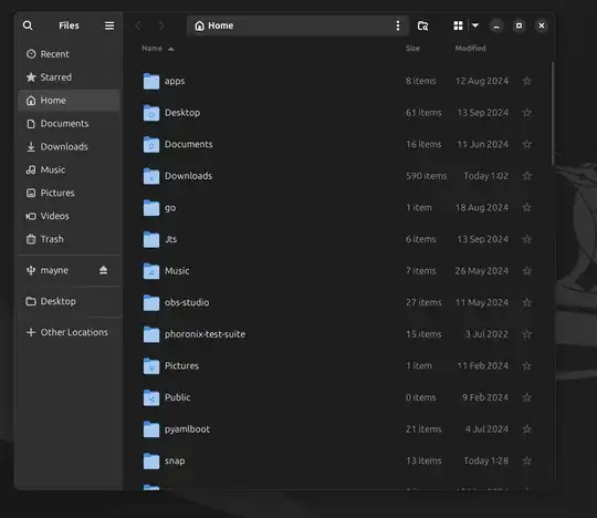

  5. Voila! Their approach was to install ppa-purge (sudo apt install ppa-purge) and to use apt-cache policy mesa-va-drivers | grep -C2 Version to validate first. Sure enough I too had the oibaf versions of the driver installed. Thus I also followed the same command: sudo ppa-purge ppa:oibaf/graphics-drivers, restarted Timmy, and it works!: Ubuntu notification centre with working font Ubuntu file explorer with working font
