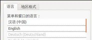

I once turned my system to Chinese, now I cannot set it back to English. I tried to change the order in Language Settings, but it doesn't work.
Chinese is always at the top. Even if I delete the language package of Chinese, it still remains. The menu of the system will return english, but all the softwares as well as the top bar remains in Chinese.

This seems a bit obvious, but you don't mention trying it so I'll answer anyway. Try click-dragging the the Chinese 汉语 (中国) list entry below the English list entry.
