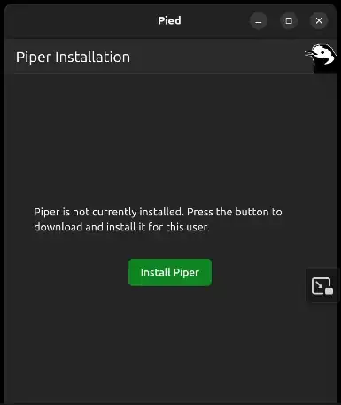

Now, open Pied. It will show an option to install the piper speech dispatcher. Install it (the app will automatically download and configure it). It will take a while.

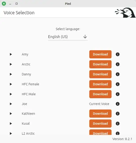

Now, the app will show you available voices. You can play them one by one, and download your favorite one. After downloading, Pied will ask you to confirm setting it as the default voice.
Afterward, close the app.
