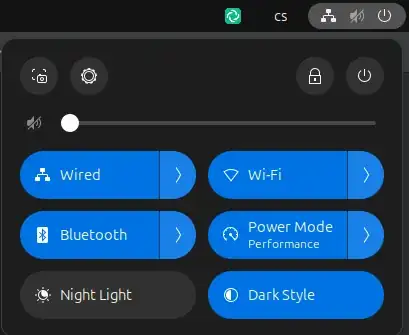

UPDATE 2: I tried to turn on the night light and play with the intensity and both displays reacted. Thank to this I think the problem won't be Kernel-related and there is still some setting missing.
I am also missing the brightness slider in top right menu, maybe this could help? Top right menu

I too got similar situation. now it fixed (not a bug) by opinions of ChatGPT. go to settings > Display > nightlight > OFF
