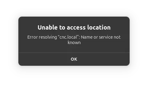

But, when I tried to open the files I get a message saying Error message from trying to open a shared file in the file manager
The problem is that I do not have a domain named ".local" that I know off. Nslookup of the same name says

So, no ".local" anywhere I can find.
OK, since gnome-user-share is not installed by default and file sharing has been part of Ubuntu for a long time, I have to assume there is a problem with the current version of file sharing.
Anyone one know if this is being worked on? (I already admitted it is beyond me.) Anyone know what the problem is? Any idea when this will be fixed?
