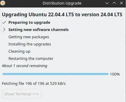

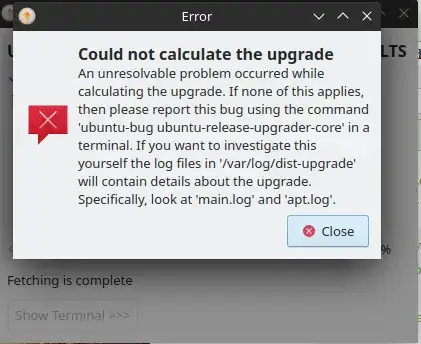

Ubuntu Studio 22.04.04 will not upgrade to 24.04. What should I do?

2025-02 Update : This issue no longer applies; refer
https://ubuntustudio.org/2025/02/lts-upgrades-22-04-to-24-04-are-back/
Original answers follows:
There is an issue with the Ubuntu Studio 22.04 to Ubuntu Studio 24.04 LTS release-upgrade process which is blogged about as follows
https://ubuntustudio.org/2025/01/upgrades-from-22-04-lts-to-24-04-lts-are-not-working/
I'll quote a summary from the upcoming Ubuntu Weekly Newsletter
The Ubuntu Studio development team bring up investigations about reported problems from users of Ubuntu Studio 22.04 LTS release-upgrading to Ubuntu Studio 24.04 LTS. Links to bugs are provided, and discussion on why this issue has occurred and difference with other flavors of Ubuntu. Further we're told the Ubuntu Studio team are working with the Ubuntu Foundations Team on possible solutions, which will hopefully be provided soon.
The problem (from official Ubuntu Studio blog) is as follows
In most flavors of Ubuntu in 24.04 LTS, the idea was to have PipeWire completely replace PulseAudio as the primary sound server and would force the installation of PipeWire. However, with Ubuntu Studio, we went with a different approach of having PipeWire be the default, but be replaced by PulseAudio if the user wished to switch back to the classic, albiet unsupported, setup. This meant PipeWire had to be a “soft” dependency rather than a “hard” one so that it could be uninstalled by our metapackages without breaking the entire desktop metapackage.
However, this also made it so that the upgrade resolver (ubuntu-release-upgrader) would get confused when calculating how to perform the upgrade. This is where we are hitting the problem.
Currently, we are working with the Ubuntu Foundations Team at Canonical on how to have ubuntu-release-upgrader force an installation of PipeWire for Ubuntu Studio without Ubuntu Studio requiring a hard dependency on PipeWire.
How this will be resolved (options described in provided article), is yet to be decided, and may take a little time. Either way, I suggest watching the Ubuntu Studio blogs for further details, or wherever you get your Ubuntu News for more (as it is known).
