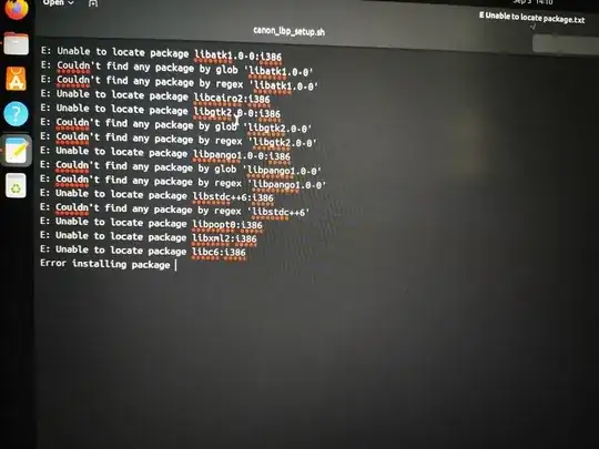

installation started but at the end the following packages were not found for installation as given in the image.
://i.sstatic.net/Jf6cf9z2.jpg
First, add the i386 architecture.
sudo dpkg --add-architecture i386
sudo apt update
Now install libpango with
sudo apt install libpango-1.0-0:i386
This package was renamed from libpango1.0-0:i386 to libpango-1.0-0:i386.
Now, download and run the installer (my fork, with fixed driver download links)
git clone https://github.com/archisman-panigrahi/ubuntu_canon_printer.git
cd ubuntu_canon_printer
chmod +x canon_lbp_setup.sh
./canon_lbp_setup.sh
Before run canon_lbp_setup.sh script, change libpango1.0-0 to libpango-1.0-0
If there are other missing packages, install them one by one, and run the installer again.
You may have to run the following, so that the computer finds the printer after restart.
sudo systemctl enable ccpd.service
sudo systemctl restart ccpd.service
