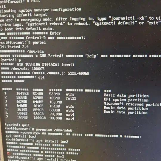

After I have entered exit, this message appears:
"failed to start default target transaction for graphical.target/start is destructive"

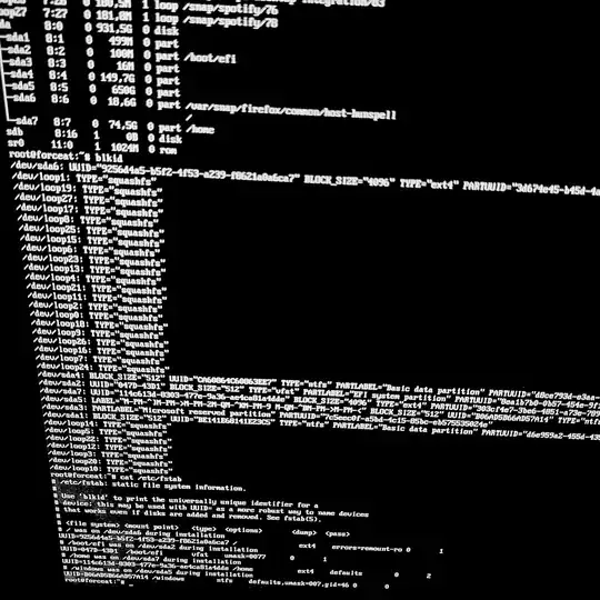

Here are the conclusions from the commands.
Previously, I tried to allocate more space for the /dev/sda6 device using the parted command as a superuser. I used the commands parted and (parted) p, along the way I forgot to inform the Linux kernel about this.
Here's picture
How to fix it?
