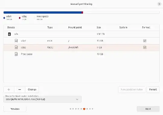

After doing some reading, and following a guide or two, my plan was to set up sdc5 as storage to be used by Ubuntu, hence the 'Type' of Linux filesystem. However, I read somewhere that the Ubuntu bootloader (the dropdown menu in the image below) should be the same one where Windows is installed on so grub can work its magic. So then my plan was to set sdb as my bootloader.
Installation screenshot from the online instructions (not mine):
Install screenshot from the online instructions (NOT MINE)
However when I set up the sdc5 as / and set sdb as my bootloader I get the error message above in the logs.
