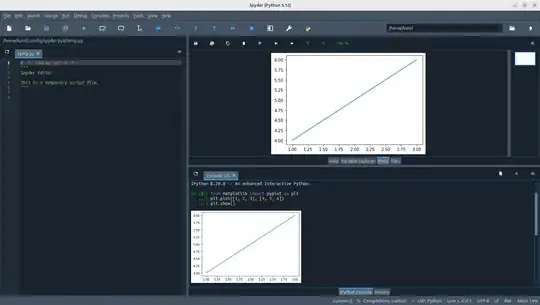

Here is the output that I got from running your code in Spyder IDE which can be installed with sudo apt install spyder in Ubuntu 24.04. This shows that there's nothing wrong with your Python code.
In my Ubuntu 24.04 the ipython3 command starts an enhanced interactive Python 3 shell which produces similar output, not surprisingly because Spyder has the python3-ipython package as a dependency.
When you try to run run the same code in the terminal nothing happens, whether you try to run it from the python3 prompt or from the ipython3 prompt. From this I conclude that there's something wrong with your terminal. Maybe it wouldn't freeze if you ran the same code in xterm (sudo apt install xterm). It's worth a try.
