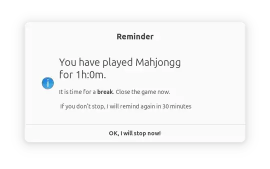

This will start the script in the background and open Mahjong. After one hour a reminder window will pop up.
You will be able to dismiss the window by clicking on the OK button at the bottom of the window. Clicking this button won't close Mahjong. If you don't click the button the reminder will close it self in 30 seconds.
If you close Mahjong, the script will exit. If you continue to play the reminder will pop up again in half an hour.

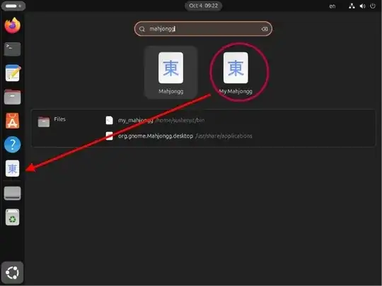

First run creates a desktop launcher
The first time you run the script, it will look for a corresponding desktop launcher file /home/username/.local/share/applications/Mahjongg.desktop. If this file does not exist, the script will create this launcher file based on the default Mahjongg desktop launcher.
If all goes well you will see 2 Mahjong icons when you search for the game to play. The first will say "Mahjong". This is the standard one. The second will say "My Mahjong" this will start the script which will start Mahjong.
2. Create a shortcut on Dash
Dash is the vertical bar on the left side of Ubuntu desktop with icons of apps that can be launched. You may want to create a shortcut of "My Mahjong" on the Dash so that you or your parent can start the game by clicking on it.
Search for the app "my Mahjong" and drag and drop in on the dock.
