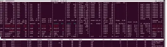

Also a warning is blinking in atop after the copy process:
Atop red NVM/crypt
The same operation with the file located on the second SSD takes a bit longer, but the system does not freeze and the IO PSI value does not spike so badly:
