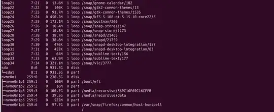

having working external hard disk which is accesble in macOS and windows ( might be NTFS but not sure ) and used to be mounted in windows and mac but when tried in ubuntu ; it gives error
lsblk
show /sda/sda1 is the address ; here is part of output lsblk output
created a directory ~/external we when write
> sudo mount /dev/sda/sda1 ~/external/
mount: /home/user/external: special device /dev/sda/sda1 does not exist (a path prefix is not a directory). dmesg(1) may have more information after failed mount system call

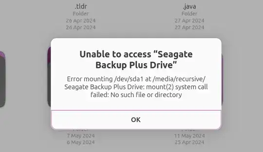

in File manager it display the drive but when click on it external hard disk error

/dev/sda/sda1 is NOT a device so fix that please The image also tells you it is /dev/sda1.
Also please drop the ~.
sudo mount /dev/sda/sda1 /home/$USER/external/
from command line. But do alter $USER to the actual directory when using /etc/fstab.
It is more useful to mount in /media is this is external storage or to a personal mountpoint in / (I use /discworld mysql). I keep my personal directories there too (ie. Desktop, Documents, etc). Makes it portable.
