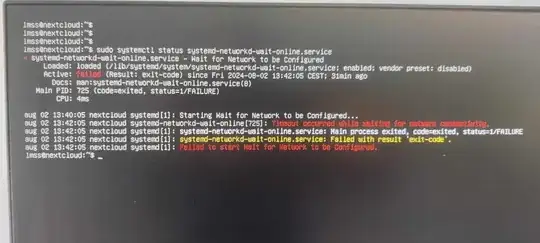

$sudo systemctl status systemd-networkd-wait-online.service
returns the same information on all devices I have tried - including also a fresh installation from this morning.
This photo shows the error:
Failed to start Wait for Network to be Configured.
