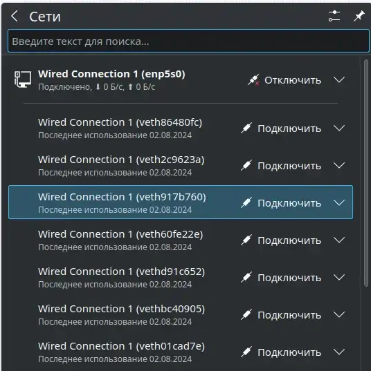

After upgrading from Kubuntu 22.04.4 LTS to 24.04 LTS, I've got a lot of connection duplicates in the tray Network Manager:
Tray Network Manager showing duplicated connections
Additionally, every few minutes I am facing disconnection and re-connection. My network programs are VPN and Docker.
The "clones" are actually Virtual Ethernet Devices and do not appear in System Settings → Connections:

Problem reason: system update replace /etc/NetworkManager/NetworkManager.conf file, that had modified by docker before.
Fix, add the following section to the end of file and reboot:
[keyfile]
unmanaged-devices=interface-name:docker*;interface-name:veth*;interface-name:br-*;interface-name:vmnet*;interface-name:vboxnet*
