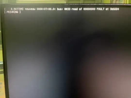

Here's what I got when booted into Ubuntu.
first-boot-error

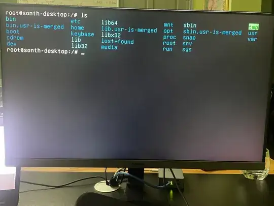

I go to the Recovery mode console, I can see all my data still there.
data

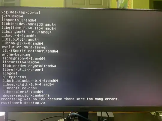

I run dpkg --configure -a, but I got this error message.
error1
dpkg: dependency problems prevent configuration of libedataserverui4-1.0-0t64:amd64:
 libedataserverui4-1.0-0t64:amd64 depends on libglib2.0-0t64 (>= 2.66.0); however:
  Package libglib2.0-0t64 is not installed.
 libedataserverui4-1.0-0t64:amd64 depends on libsoup-3.0-0 (>= 3.1.1); however:
  Package libsoup-3.0-0 is not installed.
dpkg: error processing package libedataserverui4-1.0-0t64:amd64 (--configure): dependency problems - leaving unconfigured dpkg: dependency problems prevent configuration of libgweather-4-0t64:amd64: libgweather-4-0t64:amd64 depends on libglib2.0-0 (>= 2.79.0); however: Package libglib2.0-0:amd64 is not installed. libgweather-4-0t64:amd64 depends on libsoup-3.0-0 (>= 3.0.3); however: Package libsoup-3.0-0 is not installed.
dpkg: error processing package libgweather-4-0t64:amd64 (--configure): dependency problems - leaving unconfigured dpkg: dependency problems prevent configuration of libcamel-1.2-64t64:amd64: libcamel-1.2-64t64:amd64 depends on libglib2.0-0t64 (>= 2.64.0); however: Package libglib2.0-0t64 is not installed.
dpkg: error processing package libcamel-1.2-64t64:amd64 (--configure): dependency problems - leaving unconfigured dpkg: dependency problems prevent configuration of cheese: cheese depends on libglib2.0-0t64 (>= 2.79.0); however: Package libglib2.0-0t64 is not installed. cheese depends on libgtk-3-0t64 (>= 3.21.5); however: Package libgtk-3-0t64 is not installed.
dpkg: error processing package cheese (--configure): dependency problems - leaving unconfigured dpkg: dependency problems prevent configuration of libtext-iconv-perl:amd64: libtext-iconv-perl:amd64 depends on perl-base (>= 5.38.2-3); however: Version of perl-base on system is 5.34.0-3ubuntu1.3. libtext-iconv-perl:amd64 depends on perlapi-5.38.2; however: Package perlapi-5.38.2 is not installed.
dpkg: error processing package libtext-iconv-perl:amd64 (--configure): dependency problems - leaving unconfigured dpkg: dependency problems prevent configuration of speech-dispatcher-audio-plugins:amd64: speech-dispatcher-audio-plugins:amd64 depends on libasound2t64 (>= 1.0.18); however: Package libasound2t64 is not installed. speech-dispatcher-audio-plugins:amd64 depends on libglib2.0-0t64 (>= 2.36); however: Package libglib2.0-0t64 is not installed.
dpkg: error processing package speech-dispatcher-audio-plugins:amd64 (--configure): dependency problems - leaving unconfigured dpkg: dependency problems prevent configuration of packagekit-tools: packagekit-tools depends on libglib2.0-0t64 (>= 2.54); however: Package libglib2.0-0t64 is not installed.
dpkg: error processing package packagekit-tools (--configure): dependency problems - leaving unconfigured dpkg: dependency problems prevent configuration of xdg-desktop-portal-gtk: xdg-desktop-portal-gtk depends on libglib2.0-0t64 (>= 2.79.0); however: Package libglib2.0-0t64 is not installed. xdg-desktop-portal-gtk depends on libgtk-3-0t64 (>= 3.21.5); however: Package libgtk-3-0t64 is not installed.
dpkg: error processing package xdg-desktop-portal-gtk (--configure): dependency problems - leaving unconfigured dpkg: dependency problems prevent configuration of libreoffice-gtk3: libreoffice-gtk3 depends on libatk1.0-0t64 (>= 2.11.90); however: Package libatk1.0-0t64 is not installed. libreoffice-gtk3 depends on libglib2.0-0t64 (>= 2.79.0); however: Package libglib2.0-0t64 is not installed. libreoffice-gtk3 depends on libgtk-3-0t64 (>= 3.21.5); however: Package libgtk-3-0t64 is not installed.
dpkg: error processing package libreoffice-gtk3 (--configure): dependency problems - leaving unconfigured dpkg: dependency problems prevent configuration of libtext-charwidth-perl:amd64: libtext-charwidth-perl:amd64 depends on perl-base (>= 5.38.2-3); however: Version of perl-base on system is 5.34.0-3ubuntu1.3. libtext-charwidth-perl:amd64 depends on perlapi-5.38.2; however: Package perlapi-5.38.2 is not installed.
dpkg: error processing package libtext-charwidth-perl:amd64 (--configure): dependency problems - leaving unconfigured dpkg: dependency problems prevent configuration of cups-browsed: cups-browsed depends on libglib2.0-0t64 (>= 2.79.0); however: Package libglib2.0-0t64 is not installed. cups-browsed depends on libldap2 (>= 2.6.2); however: Package libldap2 is not installed.
dpkg: error processing package cups-browsed (--configure): dependency problems - leaving unconfigured dpkg: dependency problems prevent configuration of gtk-update-icon-cache: gtk-update-icon-cache depends on libglib2.0-0t64 (>= 2.57.2); however: Package libglib2.0-0t64 is not installed.
dpkg: error processing package gtk-update-icon-cache (--configure): dependency problems - leaving unconfigured dpkg: dependency problems prevent configuration of libxml-parser-perl: libxml-parser-perl depends on perlapi-5.38.2; however: Package perlapi-5.38.2 is not installed.
dpkg: error processing package libxml-parser-perl (--configure): dependency problems - leaving unconfigured dpkg: dependency problems prevent configuration of tracker: tracker depends on libglib2.0-0t64 (>= 2.79.0); however: Package libglib2.0-0t64 is not installed.
dpkg: error processing package tracker (--configure): dependency problems - leaving unconfigured dpkg: dependency problems prevent configuration of udisks2: udisks2 depends on libglib2.0-0t64 (>= 2.79.0); however: Package libglib2.0-0t64 is not installed.
dpkg: error processing package udisks2 (--configure): dependency problems - leaving unconfigured dpkg: dependency problems prevent configuration of libwhoopsie-preferences0: libwhoopsie-preferences0 depends on libglib2.0-0t64 (>= 2.79.0); however: Package libglib2.0-0t64 is not installed.
dpkg: error processing package libwhoopsie-preferences0 (--configure): dependency problems - leaving unconfigured dpkg: dependency problems prevent configuration of libdebuginfod1t64:amd64: libdebuginfod1t64:amd64 depends on libcurl3t64-gnutls (>= 7.28.0); however: Package libcurl3t64-gnutls is not installed.
dpkg: error processing package libdebuginfod1t64:amd64 (--configure): dependency problems - leaving unconfigured dpkg: dependency problems prevent configuration of session-migration: session-migration depends on libglib2.0-0t64 (>= 2.51.1); however: Package libglib2.0-0t64 is not installed.
dpkg: error processing package session-migration (--configure): dependency problems - leaving unconfigured dpkg: dependency problems prevent configuration of libwebkit2gtk-4.1-0:amd64: libwebkit2gtk-4.1-0:amd64 depends on libatk1.0-0t64 (>= 1.32.0); however: Package libatk1.0-0t64 is not installed. libwebkit2gtk-4.1-0:amd64 depends on libglib2.0-0t64 (>= 2.79.0); however: Package libglib2.0-0t64 is not installed. libwebkit2gtk-4.1-0:amd64 depends on libgtk-3-0t64 (>= 3.23.0); however: Package libgtk-3-0t64 is not installed. libwebkit2gtk-4.1-0:amd64 depends on libpng16-16t64 (>= 1.6.2); however: Package libpng16-16t64 is not installed. libwebkit2gtk-4.1-0:amd64 depends on libsoup-3.0-0 (>= 3.0.3); however: Package libsoup-3.0-0 is not installed.
dpkg: error processing package libwebkit2gtk-4.1-0:amd64 (--configure): dependency problems - leaving unconfigured dpkg: dependency problems prevent configuration of python3-dbus: python3-dbus depends on python3 (>= 3.12~); however: Version of python3 on system is 3.10.6-1~22.04. python3-dbus depends on libglib2.0-0t64 (>= 2.16.0); however: Package libglib2.0-0t64 is not installed.
dpkg: error processing package python3-dbus (--configure): dependency problems - leaving unconfigured dpkg: dependency problems prevent configuration of libgck-2-2:amd64: libgck-2-2:amd64 depends on libglib2.0-0t64 (>= 2.79.0); however: Package libglib2.0-0t64 is not installed.
dpkg: error processing package libgck-2-2:amd64 (--configure): dependency problems - leaving unconfigured dpkg: dependency problems prevent configuration of shotwell: shotwell depends on libglib2.0-0t64 (>= 2.79.0); however: Package libglib2.0-0t64 is not installed. shotwell depends on libgtk-3-0t64 (>= 3.21.5); however: Package libgtk-3-0t64 is not installed. shotwell depends on libsoup-3.0-0 (>= 3.0.3); however: Package libsoup-3.0-0 is not installed.
dpkg: error processing package shotwell (--configure): dependency problems - leaving unconfigured dpkg: dependency problems prevent configuration of libcanberra0t64:amd64: libcanberra0t64:amd64 depends on libasound2t64 (>= 1.0.16); however: Package libasound2t64 is not installed.
dpkg: error processing package libcanberra0t64:amd64 (--configure): dependency problems - leaving unconfigured dpkg: dependency problems prevent configuration of libcanberra-gtk0:amd64: libcanberra-gtk0:amd64 depends on libcanberra0t64 (>= 0.12); however: Package libcanberra0t64:amd64 is not configured yet. libcanberra-gtk0:amd64 depends on libglib2.0-0t64 (>= 2.12.0); however: Package libglib2.0-0t64 is not installed.
dpkg: error processing package libcanberra-gtk0:amd64 (--configure): dependency problems - leaving unconfigured dpkg: dependency problems prevent configuration of system-config-printer-common: system-config-printer-common depends on python3-dbus; however: Package python3-dbus is not configured yet.
dpkg: error processing package system-config-printer-common (--configure): dependency problems - leaving unconfigured dpkg: dependency problems prevent configuration of libgeoclue-2-0:amd64: libgeoclue-2-0:amd64 depends on libglib2.0-0t64 (>= 2.79.0); however: Package libglib2.0-0t64 is not installed.
dpkg: error processing package libgeoclue-2-0:amd64 (--configure): dependency problems - leaving unconfigured dpkg: dependency problems prevent configuration of gnome-control-center: gnome-control-center depends on libadwaita-1-0 (>= 1.4~beta); however: Version of libadwaita-1-0:amd64 on system is 1.1.0-1ubuntu2. gnome-control-center depends on libglib2.0-0t64 (>= 2.79.0); however: Package libglib2.0-0t64 is not installed. gnome-control-center depends on libgnome-desktop-4-2t64 (>= 3.33.4); however: Package libgnome-desktop-4-2t64 is not installed. gnome-control-center depends on libgnutls30t64 (>= 3.7.0); however: Package libgnutls30t64 is not installed. gnome-control-center depends on libsoup-3.0-0 (>= 3.0.3); however: Package libsoup-3.0-0 is not installed. gnome-control-center depends on libwhoopsie-preferences0 (>= 0.9); however: Package libwhoopsie-preferences0 is not configured yet.
dpkg: error processing package gnome-control-center (--configure): dependency problems - leaving unconfigured dpkg: dependency problems prevent configuration of xdg-desktop-portal: xdg-desktop-portal depends on libglib2.0-0t64 (>= 2.79.0); however: Package libglib2.0-0t64 is not installed. xdg-desktop-portal depends on libpipewire-0.3-0t64 (>= 0.3.1); however: Package libpipewire-0.3-0t64 is not installed.
dpkg: error processing package xdg-desktop-portal (--configure): dependency problems - leaving unconfigured dpkg: dependency problems prevent configuration of gvfs:amd64: gvfs:amd64 depends on libglib2.0-0t64 (>= 2.79.0); however: Package libglib2.0-0t64 is not installed.
dpkg: error processing package gvfs:amd64 (--configure): dependency problems - leaving unconfigured dpkg: dependency problems prevent configuration of libportal1:amd64: libportal1:amd64 depends on libglib2.0-0t64 (>= 2.79.0); however: Package libglib2.0-0t64 is not installed.
dpkg: error processing package libportal1:amd64 (--configure): dependency problems - leaving unconfigured dpkg: dependency problems prevent configuration of libblockdev-mdraid3:amd64: libblockdev-mdraid3:amd64 depends on libglib2.0-0t64 (>= 2.42.2); however: Package libglib2.0-0t64 is not installed.
dpkg: error processing package libblockdev-mdraid3:amd64 (--configure): dependency problems - leaving unconfigured dpkg: dependency problems prevent configuration of libglibmm-2.68-1t64:amd64: libglibmm-2.68-1t64:amd64 depends on libglib2.0-0 (>= 2.77.0); however: Package libglib2.0-0:amd64 is not installed.
dpkg: error processing package libglibmm-2.68-1t64:amd64 (--configure): dependency problems - leaving unconfigured dpkg: dependency problems prevent configuration of libpangoxft-1.0-0:amd64: libpangoxft-1.0-0:amd64 depends on libglib2.0-0t64 (>= 2.79.0); however: Package libglib2.0-0t64 is not installed.
dpkg: error processing package libpangoxft-1.0-0:amd64 (--configure): dependency problems - leaving unconfigured dpkg: dependency problems prevent configuration of libgcr-4-4:amd64: libgcr-4-4:amd64 depends on libgck-2-2 (= 4.2.0-5); however: Package libgck-2-2:amd64 is not configured yet. libgcr-4-4:amd64 depends on libglib2.0-0t64 (>= 2.79.0); however: Package libglib2.0-0t64 is not installed.
dpkg: error processing package libgcr-4-4:amd64 (--configure): dependency problems - leaving unconfigured dpkg: dependency problems prevent configuration of libzvbi0t64:amd64: libzvbi0t64:amd64 depends on libpng16-16t64 (>= 1.6.2); however: Package libpng16-16t64 is not installed.
dpkg: error processing package libzvbi0t64:amd64 (--configure): dependency problems - leaving unconfigured dpkg: dependency problems prevent configuration of libnma-gtk4-0:amd64: libnma-gtk4-0:amd64 depends on libgck-2-2 (>= 4.0.0); however: Package libgck-2-2:amd64 is not configured yet. libnma-gtk4-0:amd64 depends on libgcr-4-4 (>= 3.8.0); however: Package libgcr-4-4:amd64 is not configured yet. libnma-gtk4-0:amd64 depends on libglib2.0-0 (>= 2.38.0); however: Package libglib2.0-0:amd64 is not installed.
dpkg: error processing package libnma-gtk4-0:amd64 (--configure): dependency problems - leaving unconfigured dpkg: dependency problems prevent configuration of evolution-data-server: evolution-data-server depends on libcamel-1.2-64t64 (= 3.52.0-1build3); however: Package libcamel-1.2-64t64:amd64 is not configured yet. evolution-data-server depends on libcanberra0t64 (>= 0.2); however: Package libcanberra0t64:amd64 is not configured yet. evolution-data-server depends on libdb5.3t64; however: Package libdb5.3t64 is not installed. evolution-data-server depends on libglib2.0-0t64 (>= 2.70.0); however: Package libglib2.0-0t64 is not installed. evolution-data-server depends on libgtk-3-0t64 (>= 3.10); however: Package libgtk-3-0t64 is not installed. evolution-data-server depends on libgweather-4-0t64 (>= 4.1); however: Package libgweather-4-0t64:amd64 is not configured yet. evolution-data-server depends on libldap2 (>= 2.6.2); however: Package libldap2 is not installed. evolution-data-server depends on libsoup-3.0-0 (>= 3.1.1); however: Package libsoup-3.0-0 is not installed.
dpkg: error processing package evolution-data-server (--configure): dependency problems - leaving unconfigured dpkg: dependency problems prevent configuration of libkf5notifications5:amd64: libkf5notifications5:amd64 depends on libcanberra0 (>= 0.2); however: Package libcanberra0 is not installed. Package libcanberra0t64:amd64 which provides libcanberra0 is not configured yet.
dpkg: error processing package libkf5notifications5:amd64 (--configure): dependency problems - leaving unconfigured dpkg: dependency problems prevent configuration of gnome-keyring: gnome-keyring depends on libglib2.0-0t64 (>= 2.77.3); however: Package libglib2.0-0t64 is not installed.
dpkg: error processing package gnome-keyring (--configure): dependency problems - leaving unconfigured dpkg: dependency problems prevent configuration of libmsgraph-0-1:amd64: libmsgraph-0-1:amd64 depends on libglib2.0-0t64 (>= 2.79.0); however: Package libglib2.0-0t64 is not installed. libmsgraph-0-1:amd64 depends on libsoup-3.0-0 (>= 3.0.3); however: Package libsoup-3.0-0 is not installed.
dpkg: error processing package libmsgraph-0-1:amd64 (--configure): dependency problems - leaving unconfigured dpkg: dependency problems prevent configuration of libcurl4t64:amd64: libcurl4t64:amd64 depends on libldap2 (>= 2.6.2); however: Package libldap2 is not installed. libcurl4t64:amd64 depends on libpsl5t64 (>= 0.16.0); however: Package libpsl5t64 is not installed.
dpkg: error processing package libcurl4t64:amd64 (--configure): dependency problems - leaving unconfigured dpkg: dependency problems prevent configuration of libblockdev-crypto3:amd64: libblockdev-crypto3:amd64 depends on libglib2.0-0t64 (>= 2.42.2); however: Package libglib2.0-0t64 is not installed.
dpkg: error processing package libblockdev-crypto3:amd64 (--configure): dependency problems - leaving unconfigured dpkg: dependency problems prevent configuration of libref-util-xs-perl: libref-util-xs-perl depends on perlapi-5.38.2; however: Package perlapi-5.38.2 is not installed.
dpkg: error processing package libref-util-xs-perl (--configure): dependency problems - leaving unconfigured dpkg: dependency problems prevent configuration of libgdm1: libgdm1 depends on libglib2.0-0t64 (>= 2.79.0); however: Package libglib2.0-0t64 is not installed.
dpkg: error processing package libgdm1 (--configure): dependency problems - leaving unconfigured dpkg: dependency problems prevent configuration of slirp4netns: slirp4netns depends on libglib2.0-0t64 (>= 2.28.0); however: Package libglib2.0-0t64 is not installed.
dpkg: error processing package slirp4netns (--configure): dependency problems - leaving unconfigured dpkg: dependency problems prevent configuration of libwireplumber-0.4-0:amd64: libwireplumber-0.4-0:amd64 depends on libglib2.0-0t64 (>= 2.62.0); however: Package libglib2.0-0t64 is not installed. libwireplumber-0.4-0:amd64 depends on libpipewire-0.3-0t64 (>= 0.3.68); however: Package libpipewire-0.3-0t64 is not installed.
dpkg: error processing package libwireplumber-0.4-0:amd64 (--configure): dependency problems - leaving unconfigured dpkg: dependency problems prevent configuration of libwebkitgtk-6.0-4:amd64: libwebkitgtk-6.0-4:amd64 depends on libglib2.0-0t64 (>= 2.79.0); however: Package libglib2.0-0t64 is not installed. libwebkitgtk-6.0-4:amd64 depends on libpng16-16t64 (>= 1.6.2); however: Package libpng16-16t64 is not installed. libwebkitgtk-6.0-4:amd64 depends on libsoup-3.0-0 (>= 3.0.3); however: Package libsoup-3.0-0 is not installed.
dpkg: error processing package libwebkitgtk-6.0-4:amd64 (--configure): dependency problems - leaving unconfigured dpkg: dependency problems prevent configuration of libreoffice-draw: libreoffice-draw depends on libglib2.0-0t64 (>= 2.12.0); however: Package libglib2.0-0t64 is not installed. libreoffice-draw depends on libpng16-16t64 (>= 1.6.2); however: Package libpng16-16t64 is not installed.
dpkg: error processing package libreoffice-draw (--configure): dependency problems - leaving unconfigured dpkg: dependency problems prevent configuration of libpoppler134:amd64: libpoppler134:amd64 depends on libcurl3t64-gnutls (>= 7.16.2); however: Package libcurl3t64-gnutls is not installed. libpoppler134:amd64 depends on libpng16-16t64 (>= 1.6.2); however: Package libpng16-16t64 is not installed.
dpkg: error processing package libpoppler134:amd64 (--configure): dependency problems - leaving unconfigured dpkg: dependency problems prevent configuration of gnome-session-canberra: gnome-session-canberra depends on libcanberra0t64 (>= 0.2); however: Package libcanberra0t64:amd64 is not configured yet. gnome-session-canberra depends on libglib2.0-0t64 (>= 2.16.0); however: Package libglib2.0-0t64 is not installed. gnome-session-canberra depends on libgtk-3-0t64 (>= 3.0.0); however: Package libgtk-3-0t64 is not installed.
dpkg: error processing package gnome-session-canberra (--configure): dependency problems - leaving unconfigured dpkg: too many errors, stopping Errors were encountered while processing: libedataserverui4-1.0-0t64:amd64 libgweather-4-0t64:amd64 libcamel-1.2-64t64:amd64 cheese libtext-iconv-perl:amd64 speech-dispatcher-audio-plugins:amd64 packagekit-tools xdg-desktop-portal-gtk libreoffice-gtk3 libtext-charwidth-perl:amd64 cups-browsed gtk-update-icon-cache libxml-parser-perl tracker udisks2 libwhoopsie-preferences0 libdebuginfod1t64:amd64 session-migration libwebkit2gtk-4.1-0:amd64 python3-dbus libgck-2-2:amd64 shotwell libcanberra0t64:amd64 libcanberra-gtk0:amd64 system-config-printer-common libgeoclue-2-0:amd64 gnome-control-center xdg-desktop-portal gvfs:amd64 libportal1:amd64 libblockdev-mdraid3:amd64 libglibmm-2.68-1t64:amd64 libpangoxft-1.0-0:amd64 libgcr-4-4:amd64 libzvbi0t64:amd64 libnma-gtk4-0:amd64 evolution-data-server libkf5notifications5:amd64 gnome-keyring libmsgraph-0-1:amd64 libcurl4t64:amd64 libblockdev-crypto3:amd64 libref-util-xs-perl libgdm1 slirp4netns libwireplumber-0.4-0:amd64 libwebkitgtk-6.0-4:amd64 libreoffice-draw libpoppler134:amd64 gnome-session-canberra Processing was halted because there were too many errors.

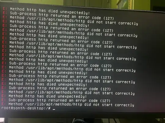

I tried with apt --fix-broken install, but I got this error message.
error2

Your output clearly shows that your system is in an inconsistent state. Sometimes that can be fixed. Sometimes it cannot.
Interrupting a release-upgrade is about the worst thing you could have done. Try to never do that.
  1. Back up your data in case a reinstall is needed or you make another "accident" for yourself.
  2. After your data is backed up, run sudo apt update. Fix any errors. Do not proceed until sudo apt update runs with no errors.
  3. After your apt sources are fixed, run sudo apt dist-upgrade to attempt to complete the interrupted release-upgrade. Read carefully the output of any errors. You might need to --reinstall a package that was incompletely installed due to the interruption.
  4. If you cannot eliminate all apt errors, or you make more "accidents" that further damage your system, then reinstall Ubuntu. Do not continue to use a broken system -- that's how you lose data.
