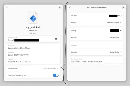

I have a bash script in my_script.sh. The settings for it are these:
and in the terminal using ls -lh:
-rwxr-xr-x. 1 blah blah  44 Aug  1 10:51 my_script.sh

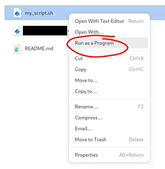

When I do right click → Run as a program, as shown below:
nothing happens. However, when I open a terminal and run ./my_script.sh, it works as expected.

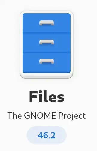

I am using "Files 46.2":
