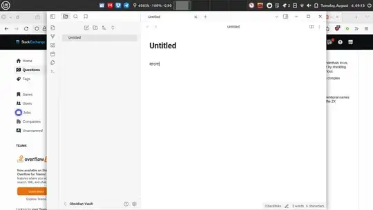

It seems to be a snap-only issue. Most likely, as snap apps are not native packages, Obsidian (installed as snap) cannot get input from ibus.
First, backup your notes and remove the Obsidian snap package from Ubuntu app store.
Next, install Obsidian deb package from its official website https://obsidian.md/download.
E.g., here is the download link for v1.6.7 https://github.com/obsidianmd/obsidian-releases/releases/download/v1.6.7/obsidian_1.6.7_amd64.deb.
Afterward, install the Obsidian .deb package (here is how to install .deb packages in Ubuntu 24.04).
Note: You may need to disable Ubuntu's new AppArmor user namespace creation restrictions for the .deb package to work.
Input from ibus-avro works. Check image below.
