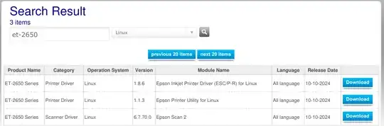

With Epson it might be beneficial to install the linux drivers provided by them.
That said I could print without the need of the drivers, but I find it works better with them.
Search for drivers
That should hopefully fix the issue.
