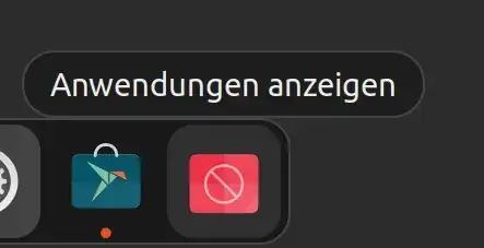

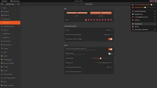

After updating my system a while ago, I noticed that multiple icons within the Desktop environment were replaced by compatibility mode icons (or at least very outdated ones) and red stop/prohibited symbols (see screenshots). These are all system icons meaning that also all system apps are affected (e.g. Terminal (+ symbol for multiple tabs), many parts of settings, the "Show apps" symbol in the taskbar, ...).

Replaced application symbol Example of missing icons in Settings app and system tray
