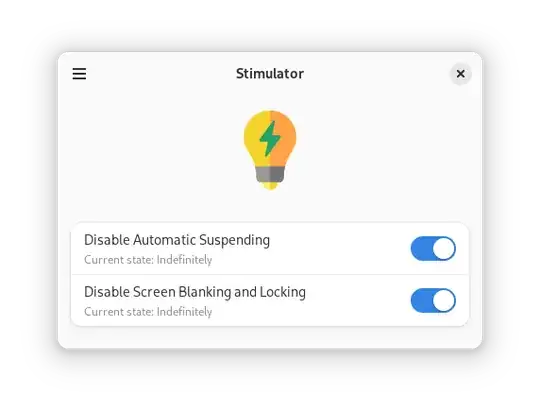

It seems that the development of Caffeine has stopped for several years. A workaround is to use Stimulator.
You can install it from Flathub. Open a terminal and enter the commands one by one.
sudo apt install flatpak
flatpak remote-add --if-not-exists flathub https://dl.flathub.org/repo/flathub.flatpakrepo
flatpak install flathub io.github.sigmasd.stimulator

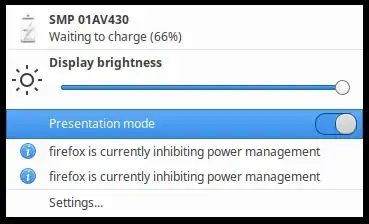

I have a hot-key ( Whisker Menu > Keyboard > Application Shortcuts ) on my laptop bound to a script that toggles presentation mode ( Panel > Power Manager Plugin ):
Presentation Mode toggle
At some point after I upgraded to 24.04 I noticed it had stopped working. However, a few tweaks seem to have fixed it:
#!/bin/bash
notify(){ # cf. https://github.com/vlevit/notify-send.sh/blob/v0.2/notify-send.sh notify-send.sh -R /tmp/presentation-mode "$1" }
pmode(){ xfconf-query -c xfce4-power-manager
-p /xfce4-power-manager/presentation-mode "$@" }
case $(pmode) in true) pmode -s false xset s 600 600 xset s blank xset s on xset dpms 120 300 600 xset +dpms notify "Presentation mode disabled" ;; false|*) pmode -s true xset s 0 0 xset s noblank xset s reset xset s off xset dpms 0 0 0 xset dpms force on xset -dpms notify "Presentation mode enabled" ;; esac
Some of the xset commands may be unnecessary.
