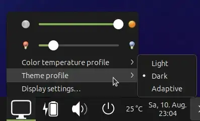

Next I figured out that some application reset that setting to prefer-light on every login. It turned out to be the "Ayatana Indicator for Display configuration", installed by the package ayatana-indicator-display. This is not contained in the standard install of Ubuntu Mate, but I picked it since I found it useful to be able to set screen sizes and orientations because I frequently switch workplaces with my Laptop.
And it turns out that this piece of software now (since the update) has not only a gsettings option to pick the preferred color scheme (dark or light), but even a UI to switch it, called "Theme profile":
Display indicator setting to pick color scheme
As soon as I set this to "dark", the Snaps finally show up in dark mode.
