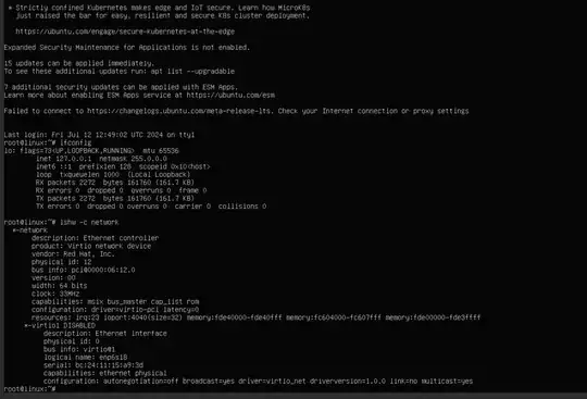

I'm migrating a HYPER-V Ubuntu VM Proxmox VE. It starts, but it has a network problem.
Ubuntu 22.04 Hyper-V was installed and running on the virtual machine, I switched it to Proxmox 8.2.2, but my network is not working.
If ifconfig is not showing another interface than the loopback, it may appear if you run "ifconfig -a" which shows all the interfaces, even the I configured ones. you have to configure the enp6s18 with the network to match proxmox.
Use netplan to configure the interface if you don't use the desktop https://ubuntu.com/server/docs/configuring-networks
Solved my problem step by step
rm /etc/netplan/*.yaml
then shutdown ubuntu
Open proxmox VM hardware delete network adapter and then add new networkadapter
Start VM ubuntu
ifconfig
Seen adapter name enp6s18
sudo nano /etc/netplan/01-netcfg.yaml
write new yaml file insert
network:
version: 2
renderer: networkd
ethernets:
enp6s18:
dhcp4: true
ctrl+o then ctrl+x save file
sudo netplan apply
Now working my virtual machine Dhcp.
