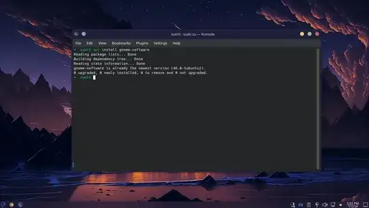

I tried to install it using the command:
sudo apt install gnome-software
which seemed to run successfully as shown in this screenshot:
terminal showing that installation of gnome-software was successful
However, even after that, I couldn't find App Center.

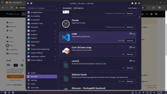

There is an Installed section there where I can see that VS Code is installed as shown in this screenshot:
VS Code shown installed in Discover.
