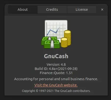

When I download GNUCash from "Ubuntu Software" I get version 4.8
