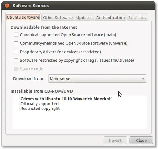

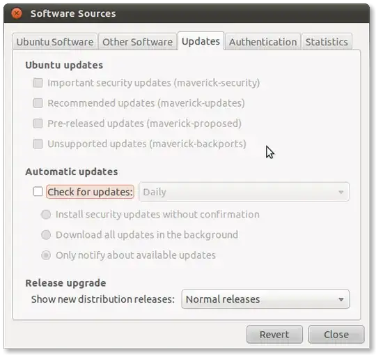

  2. Disable the repositories which you do not like to update now. You can go here to see how you can disable repositories .
See the below images to do that after opening software-properties-gtk.
  1. Then run apt-get update command in a terminal. wait till it ends.
  2. Finally again enable all repositories which you have disabled a few minutes ago. You have now updated PPA index with all previous indexes
Hope this will help.
