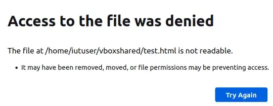

But Firefox says that it cannot open the file file:///home/iutuser/vboxshared/test.html:

With help from @steeldriver and these SO posts:
I understand that the issue lays with snap and AppArmor, see the kernel log:
[  320.509463] audit: type=1400 audit(1719786105.705:114): apparmor="DENIED" operation="open" class="file" profile="snap.firefox.firefox" name="/home/iutuser/vboxshared/test.html" pid=3298 comm=53747265616D5472616E73202334 requested_mask="r" denied_mask="r" fsuid=1000 ouid=0
I am not familiar with these applications. What and how should I configure so my snap Firefox is allowed to read my shared files?
I would like to fix it and not just reinstall Firefox from apt.
