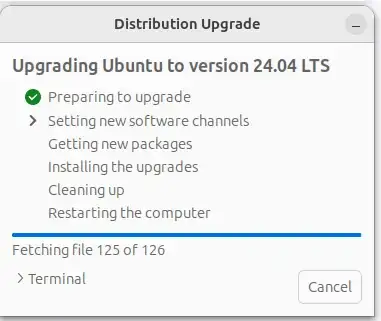

I can't upgrade to ubuntu 24.04 so far while it's launched since many weeks ago.

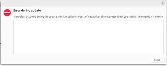

it starts fine. then it asks for enabling third part sources then it fails at (setting new software channels) second step
it shows me tab of error then it cancels whole process enter image description here
once I click ok on the error whole process gets canceled automatically
