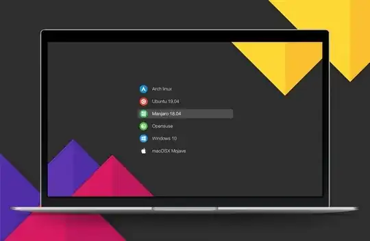

You can install the Grub themes by vinceluice.
Image source
Open a terminal and enter the following commands:

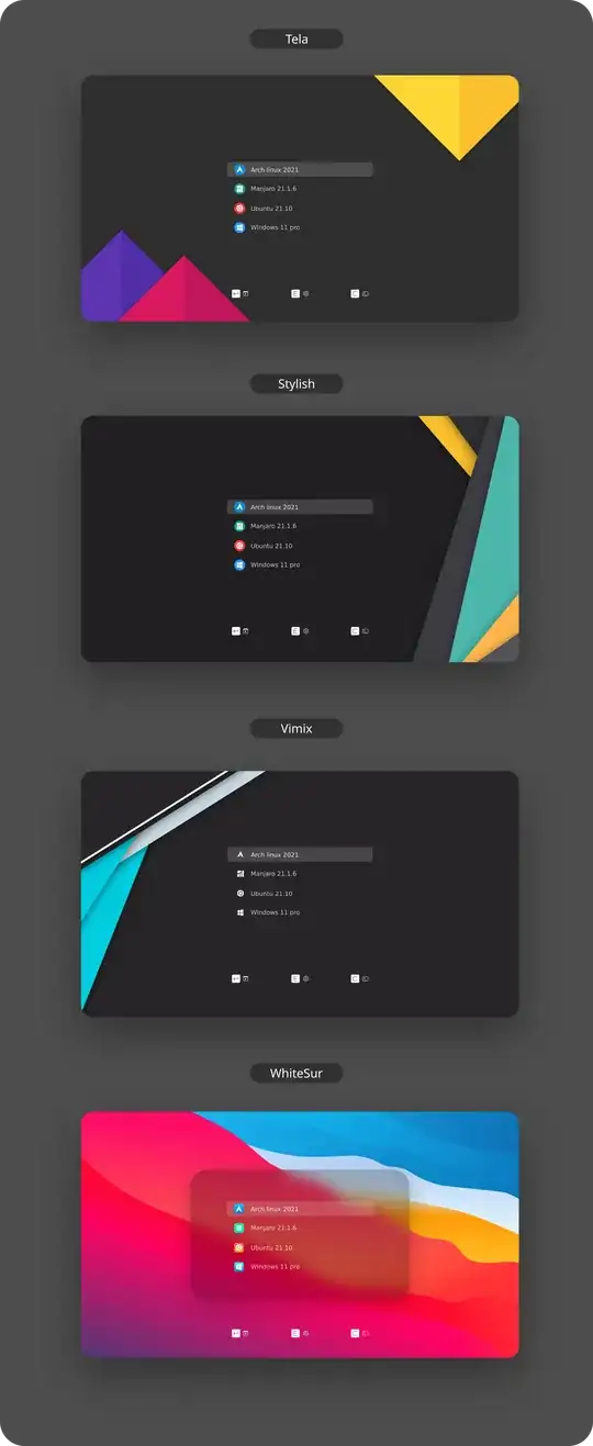

The commands above will install the "Stylish" theme, but some other themes are available as well (see image below). Check out GitHub for more details.
