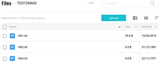

First of all, pCloud does support the modification date of the file. These are some files that I uploaded today to my pCloud account. I tested with the "pCloud drive" software (ver. 1.14.5) for Linux and also from the Web Interface using Firefox (https://my.pcloud.com/). The Linux touch -t works perfectly even on already uploaded files:
However, it seems that dates before the epoch are not supported.
