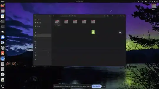

I've had loads of problems since upgrading to 24.04. I originally upgraded my previous versions but then my PC started to get lots of snow crashes. So, I did a completely clean install on 24.04. There is still the no-thumbnail bug (https://bugs.launchpad.net/ubuntu/+source/nautilus/+bug/2054183) - I tried switching on the "proposed" flag and looking for a new version off apparmor but there didn't seem to be one.
That's not my major issue at the moment though. I've now got a significant graphics problem - see below.
My graphics card is an Nvidia GeForce GT 710.

Try adding to /etc/environment the line:
GSK_RENDERER=gl
And then restart (or execute sudo systemctl restart gdm.service).
If that doesn't help, try adding one more line to the same file:
GDK_DEBUG=gl-prefer-gl
This has helped a lot of people to solve a lot of similar issues:
  1. Ubuntu 24.04 screen glitches on gnome apps after install
  2. 24.04 LTS Texts don't appear until hover
  3. Missing text in dialog windows
For further info and/or discussion see:
  1. https://www.reddit.com/r/gnome/comments/1bnjx22/gnome_apps_do_not_show_text_unless_fullscreen/
  2. https://www.phoronix.com/news/GTK-4.15-Vulkan-Default
  3. https://blog.gtk.org/2024/01/28/new-renderers-for-gtk/
