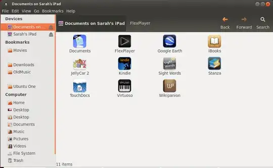

Navigate to 'Documents on My iPad' (again, your name will vary) and find the application you just installed. It will look like an application with an icon but it is actually a folder for that app and its files (the user accessible ones at least).
Example of 'Documents on My iPad' mount
Open that folder (i.e. double click on it) and then open the Documents folder within.

If you do not see your application when navigating in your "Documents on My iPad" folder, you may need to show the hidden files CTRL-H.
