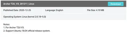

I'm using archer T2U v3 in my 14.04 and 16.04 system flawlessly as the driver was directly provided by TP-Link from their website https://www.tp-link.com/en/support/download/archer-t2u/#Driver (Kernel version 2.6.18~5.0) enter image description here According to their PDF link https://static.tp-link.com/2018/201812/20181207/Installation%20Guide%20for%20Linux.pdf I just had to use make command to compile their driver and load it by sudo insmod 88x2bu.ko.
Recently I upgraded my system and found that direct make command don't work from Ubuntu 18.04 onward as it says make should be installed first.
