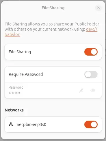

I am trying to activate the file sharing on ubuntu.as you can see here
All good and well, but even after a reboot, I am faced with this problem when I am opening the /home/$USER/Public directory. enter image description here
I latter on copy some files in the Public directory and the other user(that DO HAVE FILE SHARING ACTIVE) see nothing:

You should install the nautilus-share package:
$ sudo apt-get install nautilus-share
