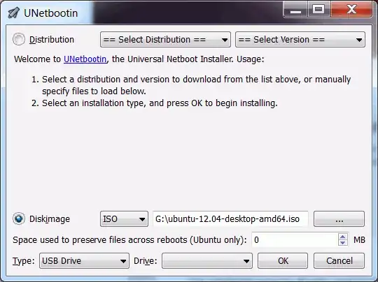

I think someplace I read about needing to Create A Start Up Disk but I am having a hard time finding a explanation simple enough for a 3 year old to follow that will help me do this WITHOUT the SOFTWARE CENTER which will not even open up.

How to create a startup disk (USB) from Windows 7
  • Insert your flash drive into the Win 7 computer, and copy the ISO you already have to somewhere on your hard disk (e.g. My Documents). Also copy any backups, etc. on the flash drive because turning it into a startup disk will wipe all existing data off it.
  • Simply download and run UNetBootin in Windows 7 (note: the link will take you to a direct download).
  • Point UNetBootin to the ISO you saved (Diskimage:), and to your flash drive letter (type must be "USB Drive". Click OK to create the disk...wait for it to complete, and you're done!

As to your question, if you just copied the files to your flashdrive and did not use a start up disk creator it will not be bootable. Here is a link to Ubuntu's website that is easy to follow and will use a program that should already be on your computer(unless you have removed it) called "Start Up Disk Creator" it will allow you to get a bootable iso on your flashdrive. Then you should be able to install from it just select the option to replace Ubuntu on the install screen.
http://www.ubuntu.com/download/help/create-a-usb-stick-on-ubuntu
