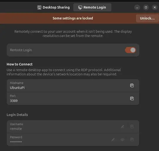

For me on the target PC I edited the login details at the bottom of the Remote Login screen in System -> Remote Desktop and used those login details from another PC's RDP client.
Target PC:
screenshot of target PC
