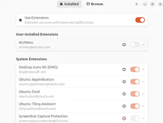

I have Gnome Shell Extension Manager installed. When I install an extension, such as ArcMenu, I am unable to activate it due to the slider being grayed out.
Things I have tried:

Screenshot

Looking at the extension from Ubuntu 22.04, I see that ArcMenu is listed as an Unmaintained project and that all related repositories have been officially archived.
In Extension Manager is is listed as Unsupported.
As for the others, this Ask Ubuntu Question may provide a solution.
