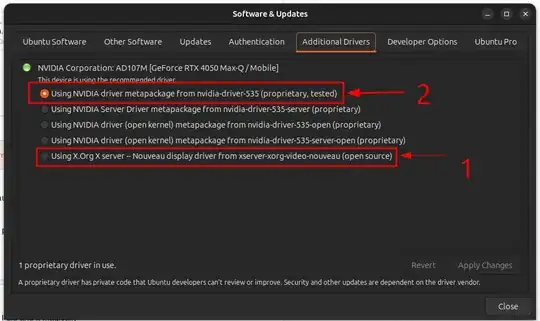

I did everything everyone mentioned but it didn't work straightforward. So here's what I did and it magically fixed the problem.
Search for driver in your applications list in ubuntu 24 and open Additional Drivers
Here on this page select the option xserver-xorg-video-nouveau and click on Apply Changes
When it's done, reboot, come back to Additional Drivers and pick first option, nvidia-driver-535
Just like this image: enter image description here
