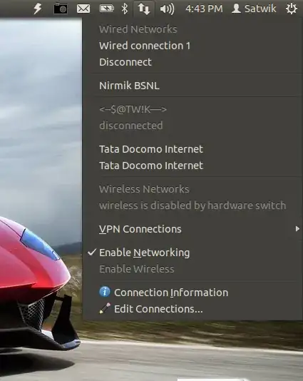

I'm not able to enable Wireless using the hardware switch on my HP ProBook4430s.
Because of this the Enable Wireless option is greyd out and I cannot enable it.
The greyd out option can be seen in the screenshot below.

Try when booting your computer:
  1. press f2? to get into bios
  2. press f9? to reset to default settings
  3. press f10? to save settings
Check if you're still hard blocked.
[keys are for my laptop which isn't a dell]
JSt
  • 477
Try doing
sudo rfkill unblock wlan
Then
sudo ifconfig wlan0 up
And report, by editing again your post, if there are errors.
