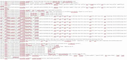

I am running a fresh install of 24.04 on VirtualBox 6.1.50_Ubuntu r161033 (with a Ubuntu 22.04 host). App Center opens to a white screen and immediately closes. Below is a screenshot of the relevant portion of the syslog. syslog
