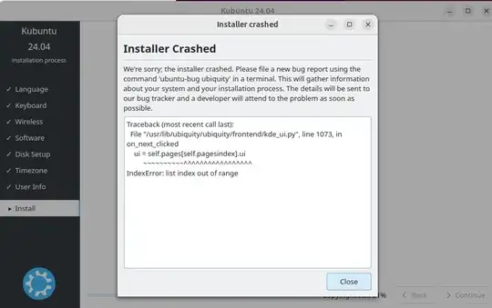

I am also trying install ubuntu 24.04 on the internal SSD of a mac mini 2018. I followed this process but ended up with the crash the following crash error enter image description here.
To get here I booted with "try or install ubuntu". Then I went to the terminal, I runned ubiquity -b (which before I had to install with sudo apt-get install ubiquity). After, I selected the FAT32 partition I previously created and tried to install Ubuntu but got the message shown in the image above.

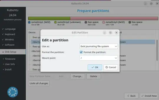

This is how the partitions looked. I selected te Fat32 partition as Et4 Journaling and mount point / as the following image shows: enter image description here
