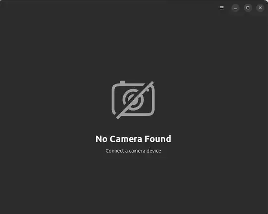

The camera not working in Ubuntu 24.04.

Steps to solve this issue: (It works for me and should work for you also)
1) Open the Terminal CTRL + Alt + T
2) Update the package lists from the repositories
~ sudo apt update
3) Restart pipewire
~ systemctl --user restart pipewire
4) Run snapshot from terminal. The package name of this camera app is snapshot
~ snapshot
It should work from now on.
If the "Camera" app doesn't work for you...
Add yourself to the "video" group and it'll work fine.
sudo adduser $USER video
Then you MUST log out, then use this command to check if you're in the video group:
groups
If you don't show up there, then you MUST reboot.

I fixed this by installing a package for media devices:
sudo apt-get update
sudo apt-get install v4l-utils
Then check if the camera is detected:
v4l2-ctl --list-devices
Finally, open the Ubuntu camera:
snapshot

Dell laptops with MIPI webcams (like Latitude, Precision, XPS) do not work on Ubuntu 24.04 LTS. The problem? Ubuntu 24.04 doesn’t currently support MIPI webcams, nor has the drivers ready befre shipping the new version :) Dell and Canonical are working on it, but no fix yet.
Dell confirmed this problem for the following models:
Latitude XPS Precision
7340 9315 5470
7440 9320 5480
9430 9340 5490
7640 5680
5690
FIX ?
For now, if your camera is important, it's best to stay on Ubuntu 22.04 since the issue only happens after the upgrade.
Here’s the link to the Dell article: https://www.dell.com/support/kbdoc/en-us/000201043/mipi-webcam-does-not-work-on-ubuntu-24-04-lts
