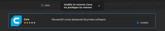

I was installing Cura slicer and I got a software update notice and decided to update software too. the software updater said it was waiting for something to close, which was the snap store installing cura. so I canceled the cura install so I could install the software update.
now cura shows it's installed in the snap store but doesnt show up under my apps on my system. The snap store also wont let me uninstall it saying "no packages to remove" I want to install it but I cant install it since it thinks it's already installed. It doesnt show up under the updates tab either.

Run the snap list command to check if the Ultimaker Cura application is installed. If Cura is not installed then you can install it from the terminal with the following command.
sudo snap install cura-slicer
To enable detecting removable USB media run the following commands:
sudo snap connect cura-slicer:mount-observe
sudo snap connect cura-slicer:removable-media
If snap list shows that Cura is installed its icon should appear in the applications dashboard after rebooting the system. Rebooting the system will automatically mount all installed snaps.
