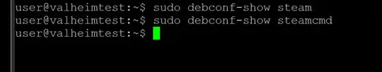

However, it appears this no longer works, example
show console commands above being executed, with no outputs
I have also tried the debconf-set-selections commands above, to no effect

After a fresh install I have found out why debcon-show had no output
It will not show until you run apt update after adding the non-free repo
The following commands will install steamcmd without interactive interruption. On a fresh debian 12-based distro.
echo deb http://deb.debian.org/debian/ bookworm non-free >> /etc/apt/sources.list
dpkg --add-architecture i386
echo steam steam/license note '' | debconf-set-selections
echo steam steam/question select "I AGREE" | debconf-set-selections
apt update
apt install steamcmd -y
